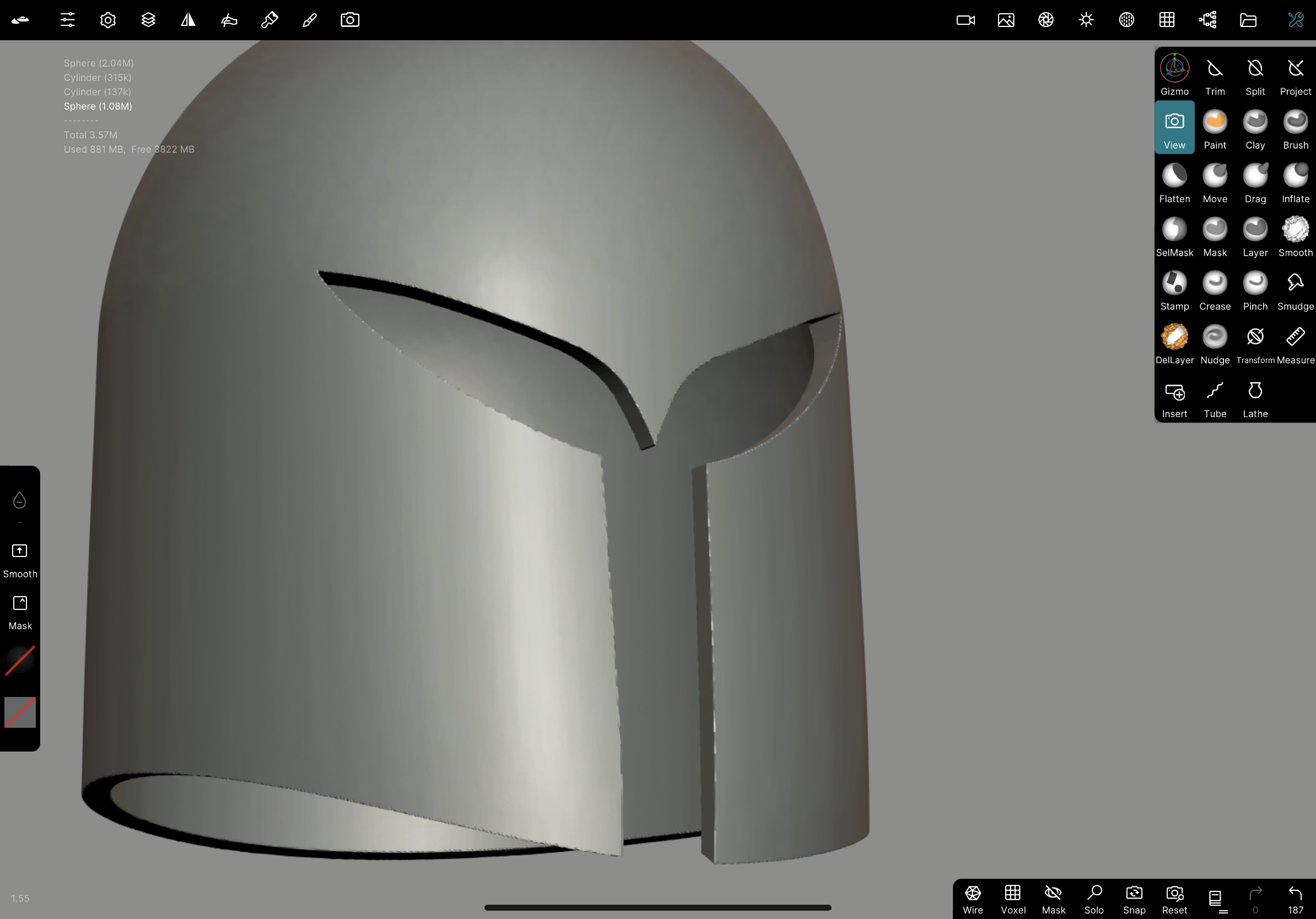

Loss of quality when doing "voxel merge"
Are really deformed or is it just the shading (toggle smooth shading on/off to find out)?
Voxel remeshing can’t really be used to retain sharp edges in Nomad.
Trim tool will produce sharp edges though (but since it doesn’t have regular topology on the cut it will only appear nicely with smooth shading off)
Sometimes I use the “trim” tool or sometimes “voxel merge” to cut pieces …
In this case I use trim to make the holes in the helmet visor and “trim for the” ridge "above and the result is almost the same. … “soft shading” is disabled.
In this object it is easier for me to cut the opening of the helmet with “trim”> “polygon” … And the result is not clean … I don’t know why this happens on the right side and on the left it is perfect …:thinking:
Yes the Trim doesn’t cut perfectly, I only meant the “edges” of the cut only, not the filled part.
It’s not really proper boolean, so it can break sometimes.
Line mode should work correctly however.
I’m using voxel merge to make holes in the main shape … It gives me better result than “trim”
