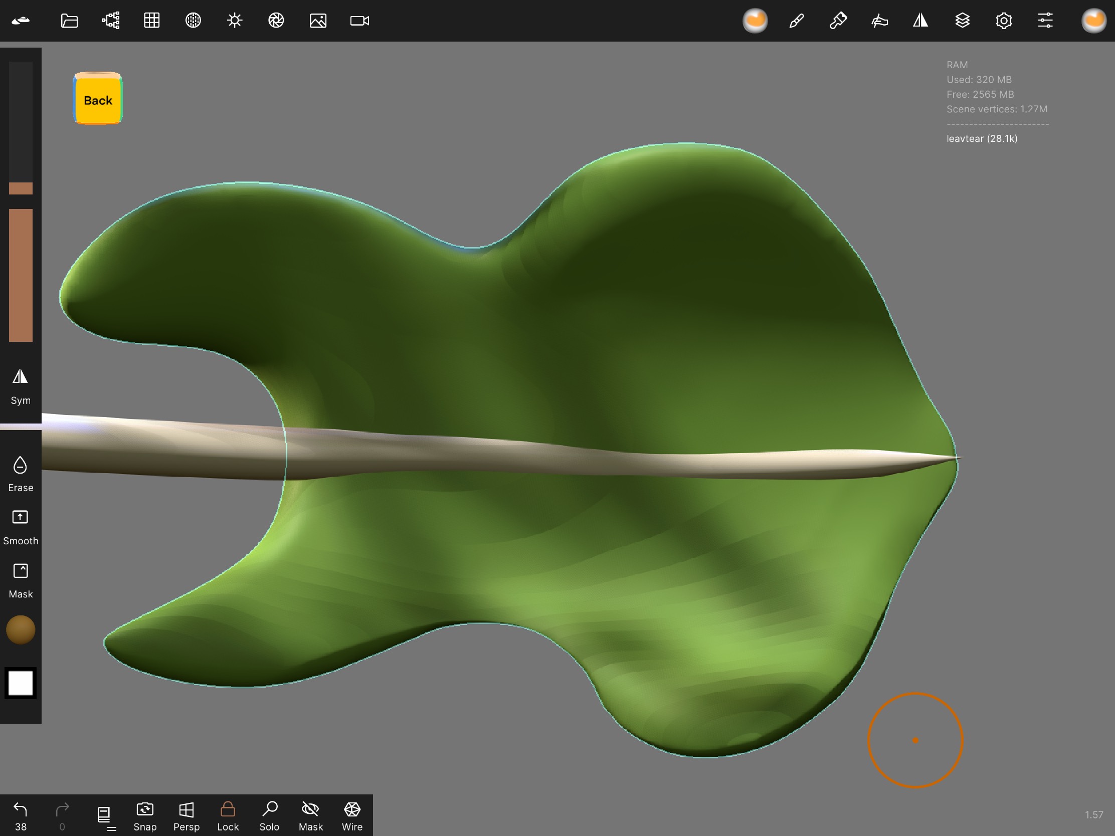

Interference pattern using spot light
don’t know if it really is a bug or a feature. But, if I use a spot light (3 light setup) I see an interference pattern appearing on the surface. Switching it to point light let it disappear.
First picture is with spot light, on the second I switched it to point light.
I played through all post processing settings, but only switching spot light to point light helped.
Btw: Android, Samsung Galaxy tab S7
Have you tried to switch of shadow on spot light?
I guess the issue is there.
Here, both time shadow is on. But in the picture with artefacts, I placed an object between light & leaf dropping a shadow.
Same issue with directional light.
Could you send me the glb file, with everything set up so that the bug appears when opening the file?
Thanks, I sent you a mail.
Ah thanks!
I wanted to reply to @knacki as the file looked simpler.
As I suspect I don’t replicate the bug on my iPad Air4, probably a GPU things. It’s definitely caused by shadows though.

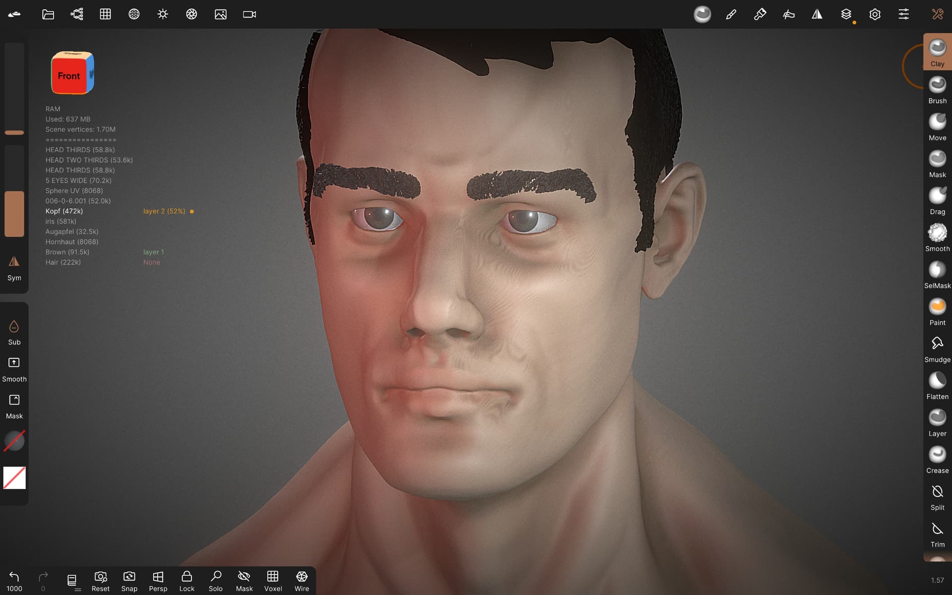

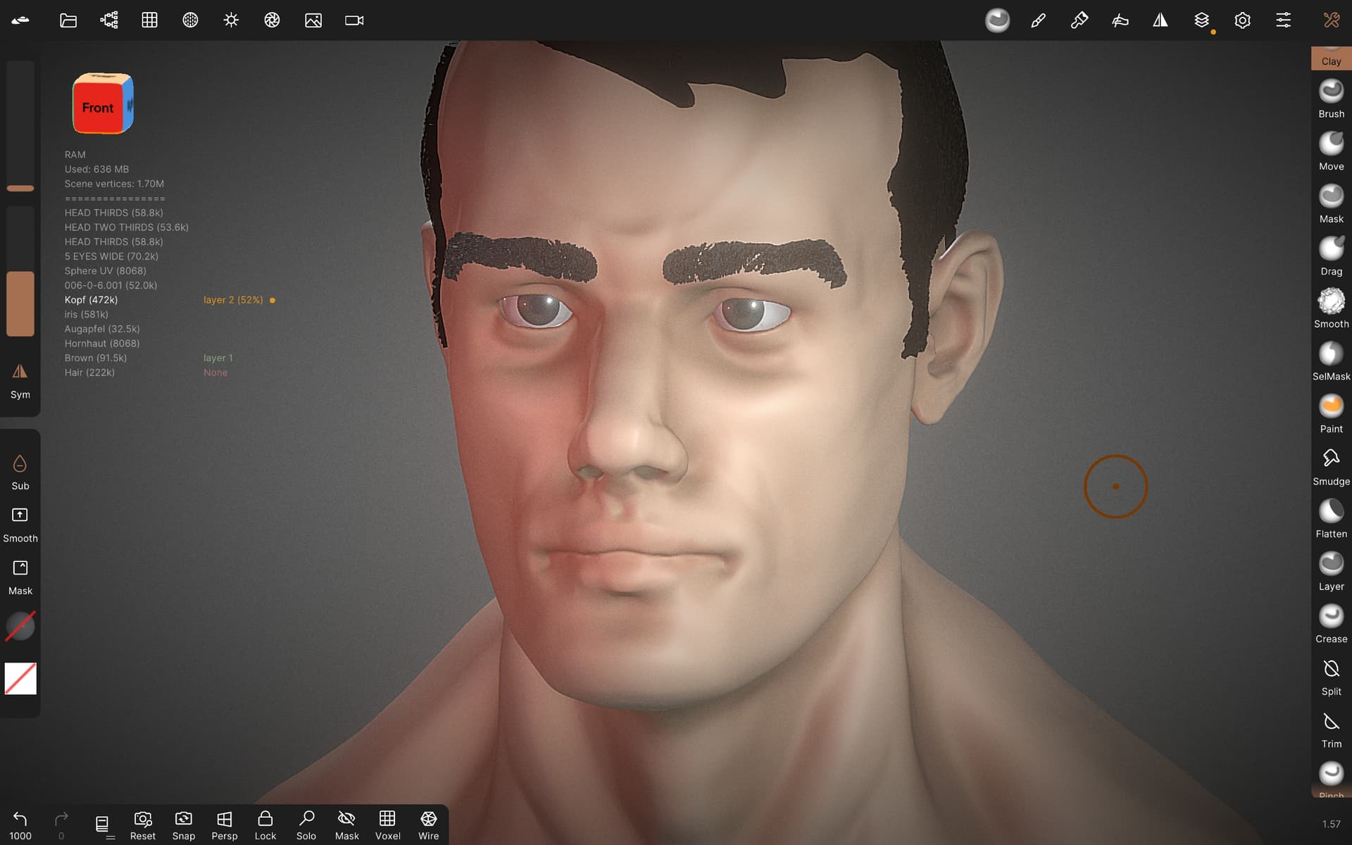

Update: if I delete the non-visible object: 006-0-6.001 in my file the interference is gone. So… something related to this object seems to induce this interference. Maybe @knacki has also an invisible object in his scene?

@knacki Could you send me your file?
I replicate the issue with spot light on @Aszrael model but not with directional light.
Directional are different enough from spot light that it might be another issue, so I’d like to check that out.

As for your model @knacki I didn’t spot any issues on my device.
The 2 objects are small relatively to the entire scene, so the shadow will definitely be very blur due to the low resolution shadow map in Nomad. But I don’t see the same patterns as in your screen.
