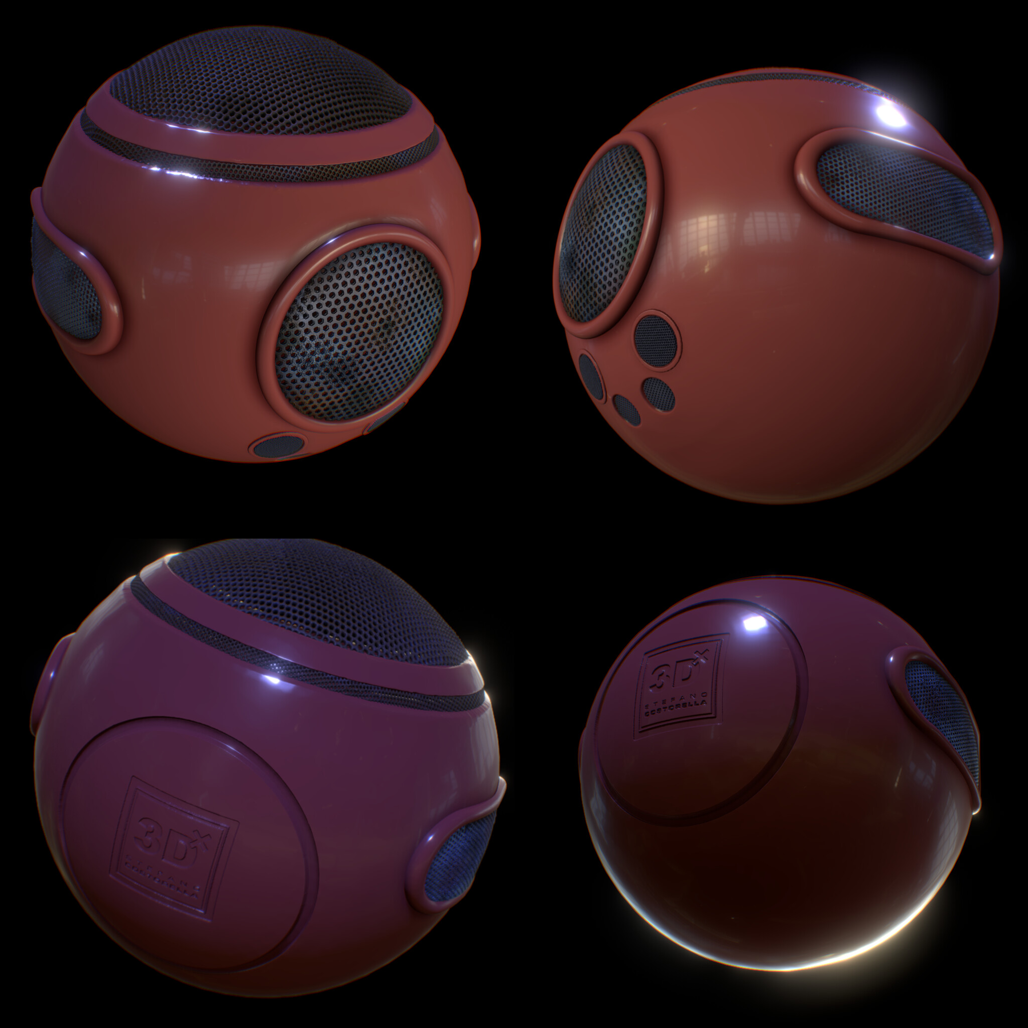

I’m trying stuff today it was grids with tiny little holes, I thought I should go up a lot in resolution but no. better, after a global remesh decimation or uniformization with a lot less polygons the result was better.

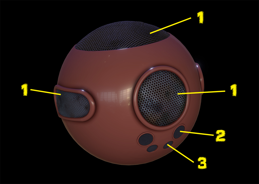

I try to explain
1 - I used the masks to cut out the small pieces on which I was going to apply an intense voxel remesh. Then with an alpha with points in Grab mode I created the grid with a mask and then I used extract that’s all, it’s not complicated at all actually
2 - I tried something else always with the mask and the same alpha but this time I used clay in screen project mode, I have less of this technique because I used dynamic topology only on the circular space than I needed but suddenly it creates artefacts in the mesh around and therefore it is necessary to soften it is less precise but it is fine.
3 - 3 - For those I used I wanted the grid to be under the height of the surface so the first technique did not work so I used technique 2 by first digging the hole with a round mask and I then erased the artefacts that appeared because of the dynamic topo then I used clay to take the grid out of the hole.
It really is not complicated.
