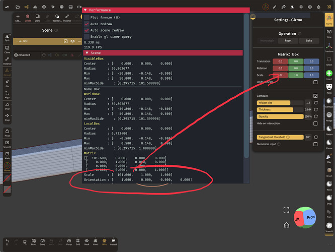

I’ll increase the precision display but your issue is different here, you should write x+0.1 instead, x is the real value
Of course, I was also curious, I think you can see the „real“ value in the performance log. And the thing with X instead of the value works.
But that’s actually under! DEV
Technically you never see the “real value”, the log simply shows more precision.
The real value is 101.59999999999999432
Thanks for this. I didn’t know this existed. It will definitely be helpful in determining the actual value after letting the input do the calculations, and then using the x+ method above.
