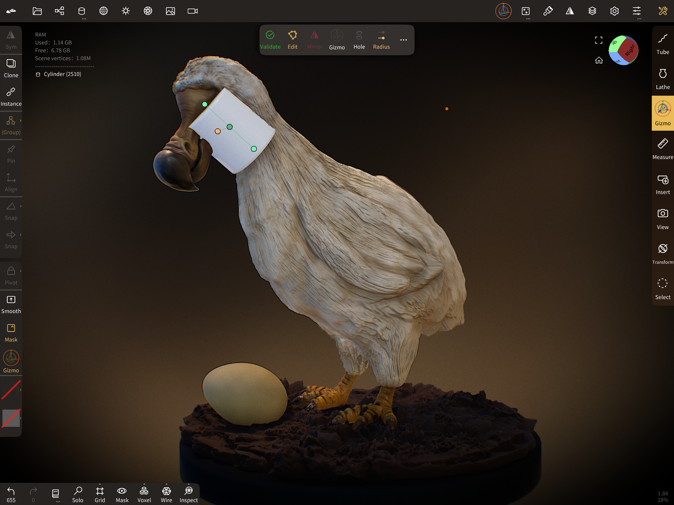

Anyone had this before: Whenever I create a new object like the cylinder In the attached screenshot screenshot all the axis are tilted. It seems my whole scene got twisted around somehow? Is there an easy way to reset this?

Check your settings when adding an object. Uncheck the options to bring an object in on world center.

Thanks, I unchecked both options but the newly created objects are still twisted.i think it. Ight be related to the fact I started with the head and then extended the body and while doing so at some point I must have messed up the orientation of my scene.you can clearly see how the hdri is tilted as well
It’s the camera itself that’s twisted, you can see it with the snap cube.
Maybe consider disabling « trackball » in the camera menu.
twisted? So what :slight_smile:
You rotated the object, that’s all. Simply use the gizmo and rotate it back.
There is no bug
Roger that there is no bug. Only users :slight_smile: thx
