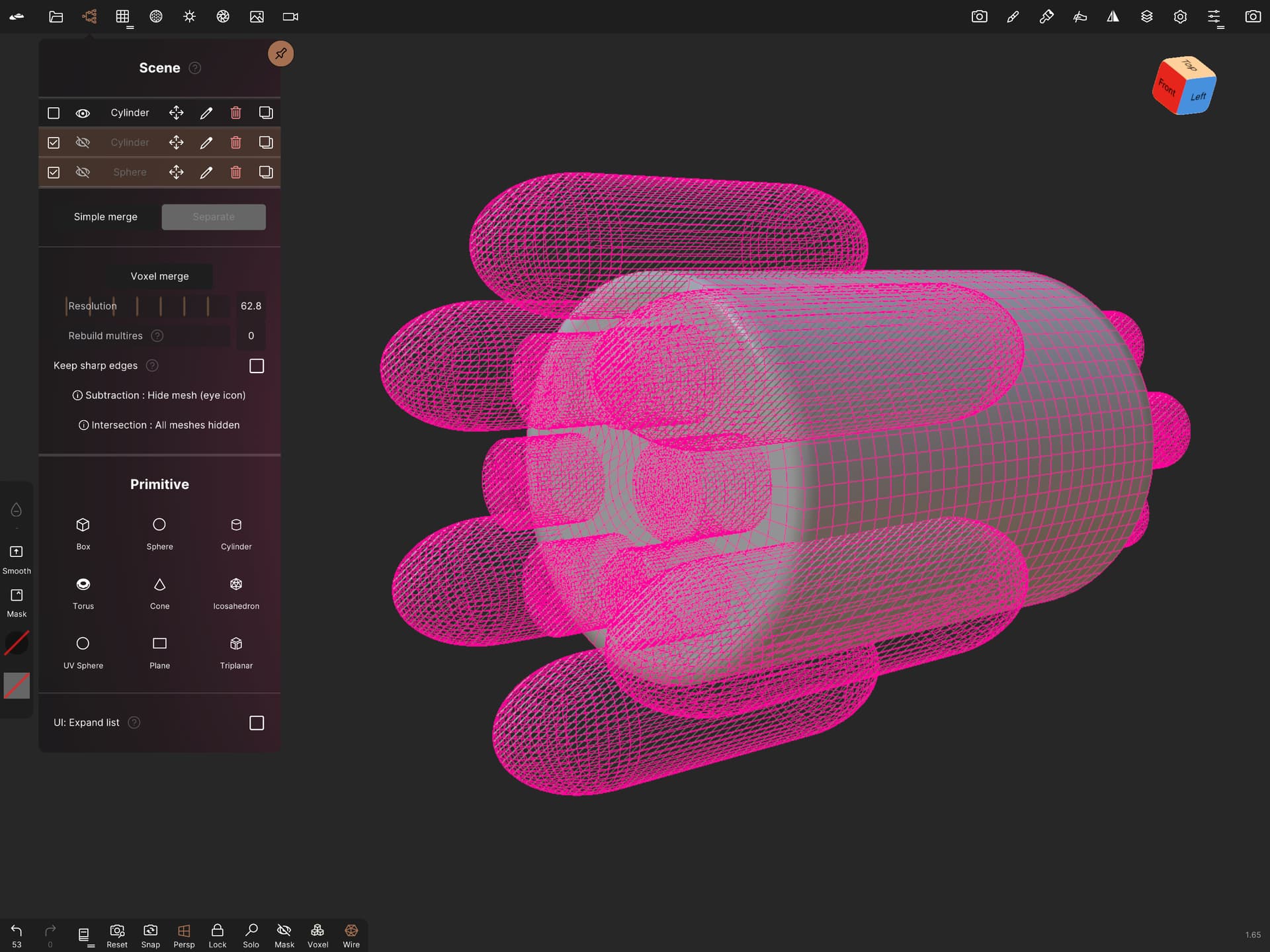

It definitely is, just not in such a fluid way. You’d probably make up for time in nomad with the ease of manipulation of primitive. The equivalent workflow in Nomad would be that you arrange the main “positive” primitives & then arrange the “negative” or cut primitives. Hide off “negatives” in scene list. Then select all “positive” and “negative” objects in scene list & voxel remesh them into one object, maybe select keep sharp edges & also undo & experiment with resolution until you get a nice result. Then start adding extra positive & negative masses to cut or add further detail. Rinse and repeat until you get the desired result.
First image shows all main objects intersecting to form a 6-shooter gun barrel. Second images shows the “negative” objects set to hidden in the scene menu & third image shows the result from a voxel remesh with, in this case, a value of 600, in order to get a reasonably sharp result.
