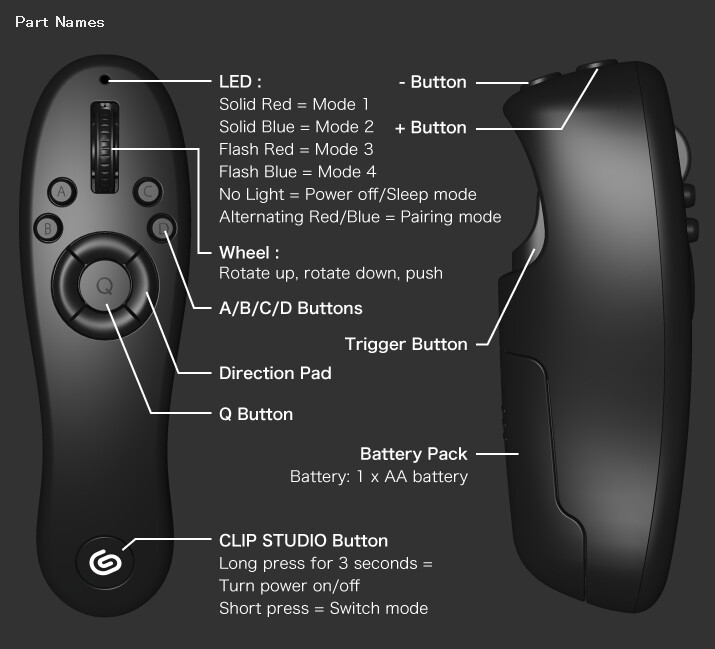

I have a Tabmate Pro for the Android Clipstudio app and I think it would be nice if Nomad supported it
It is a one handed bluetooth keyboard with a scroll wheel CLIP STUDIO TABMATE
It sends normal key up and key down keystrokes like any keyboard, but in a “strange” range (scanCodes ~300-700)
I noticed there’s already automatic keyboard mapping in the demo. Maybe it could be extended so also smooth, mask and Radius (scrollwheel +/-) and scanCodes outside of the standard ASCII range could be mapped.
That should already be enough to support this device and similar devices (don’t know of any others :woozy_face:). If it makes sense I can make a list of the exact scan codes/button mapping.
