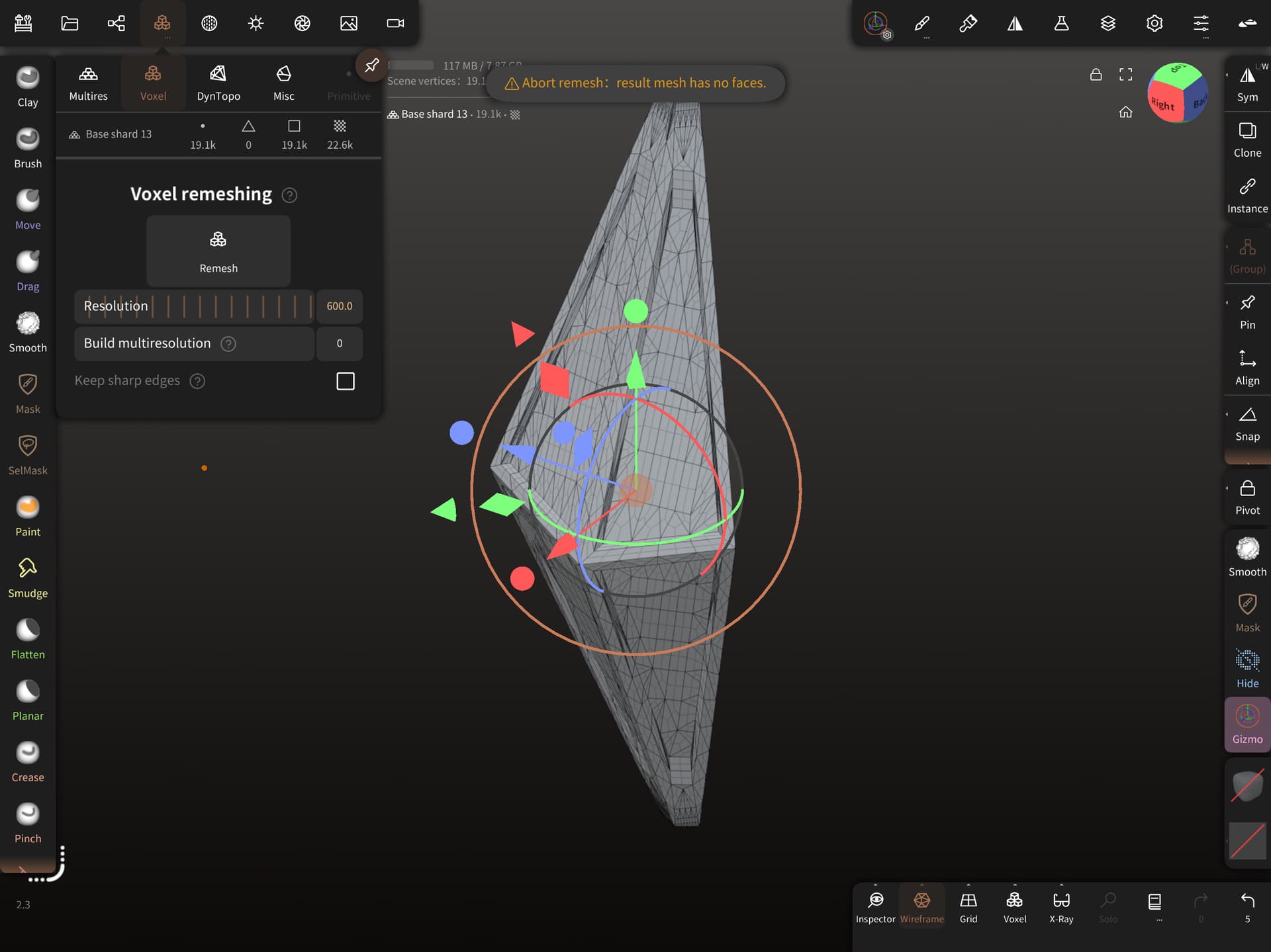

I’m trying to remesh an OBJ that I’ve brought into Nomad. It has no holes, is a single object and is manifold. But when I go to Voxel Remesh I get a (result mesh has no faces) error or some random floating faces. Im never come across something like this before. I feel Like I’m missing something simple.

I have tried it either gives the same Error message or disappears. With a few floating faces. I’m fairly certain it has something to do with the model but I’m struggling on what it could be. This has been a tried and true workflow until now.
It can only be holes.
Voxel remesh requires the mesh to be watertight, Nomad will perform a hole-filling algorithm first, but it’s not 100% foolproof.

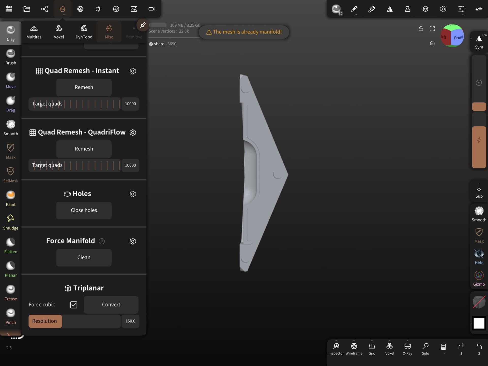

In the topology menu, you can try the “close hole” or “force manifold” button a few time.
If it doesn’t work try to see in your object where there’s a “leak” and simply use the move tool to cover it up.

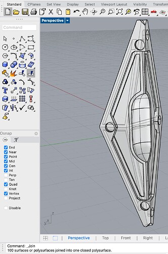

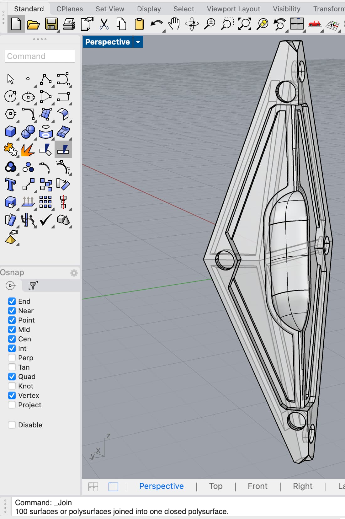

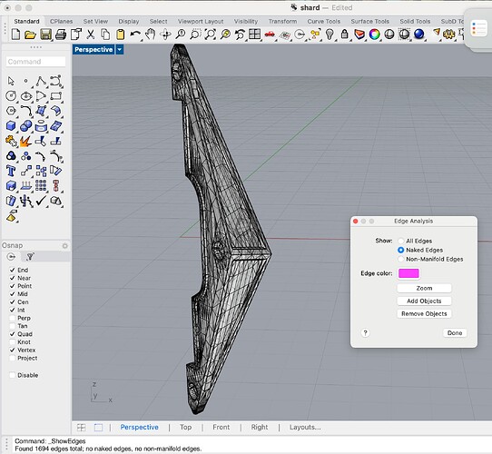

I’ve tried “close holes” and force manifold in both Nomad and Rhino. No naked edges and No Non-Manifold edges. In Rhino I double checked if I had duplicate faces in the original surface model. No Luck.

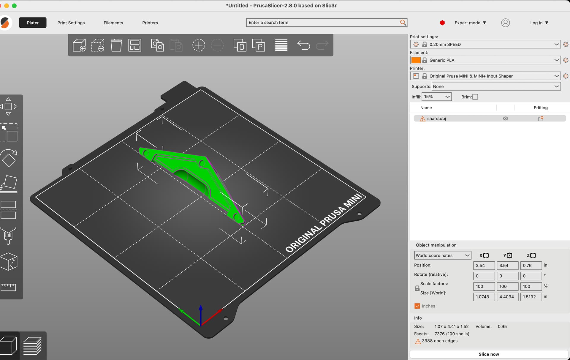

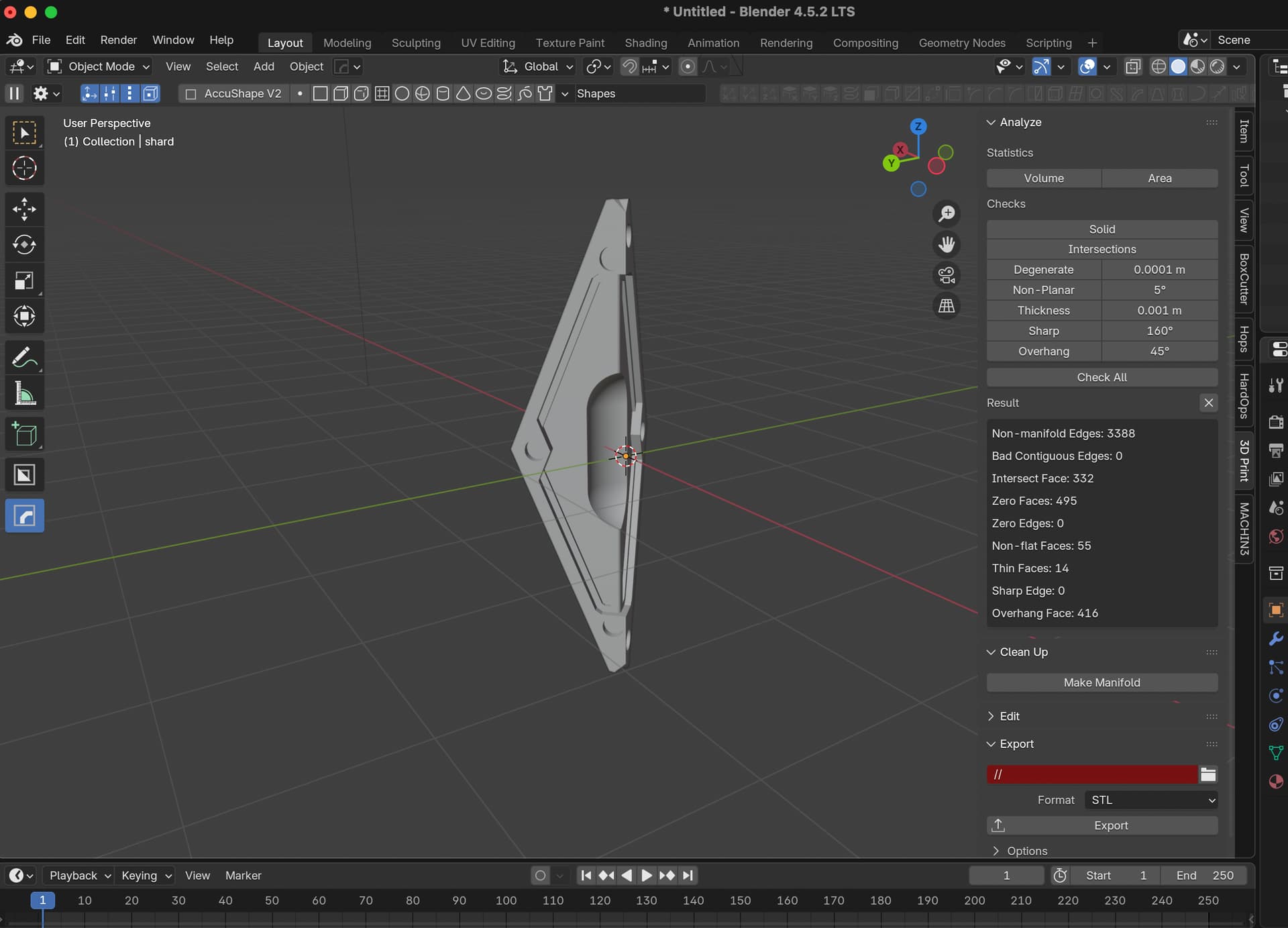

I imported the file into Blender and ran the 3D print add on and loaded it into Prusa Slicer as well. Both are saying there are 3380 non-manifold Edges. I ran Make Manifold and parts vanish. I was able to run Quad Remesher and that looked ok.
Interesting. I wonder why Blender reads it differently than Rhino and Nomad

Both file types in Blender/Prusa Slicer. Same result.
