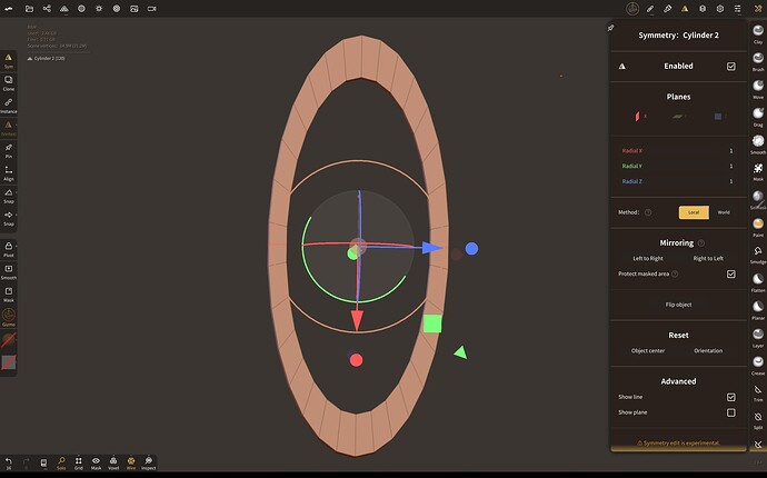

So I am continuing to make braclets. Now I am trying to make a link for a braclete chain.
I tried with torus but I was unable to give it a chain link shape with out getting deformation on two of it sides. Meaning its thickness changes.
Now I am trying to use Holger method used in the video “Chain along path”
I can not use world symmetry because I need the chain to be on a curve repeater in the right wrist of the character. I am using loca symetry.
When I activate symetry the gizmo does not move to one side like in the video it stays in the middle
And I get the same deformation on the hollowed cilinder that I was getting in the torus.
What is wrong?

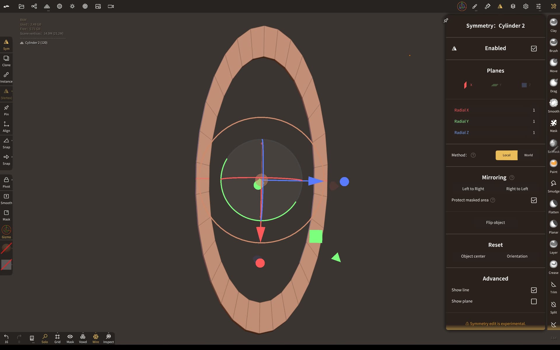

Ok. I finally figured it out I was enlarging the wrong plane ![]()
I tried it in the world center this time , but that shouldn’t be the issue.
Edit: Actually that wasn’t the issue, because I got the same problem again.
The problem is that I was moving the dot to enlarge, instead of the arrow to move.
When using the dot I ge the deformation. When using the arrow I get it right shape.
SO many details to figure out.
