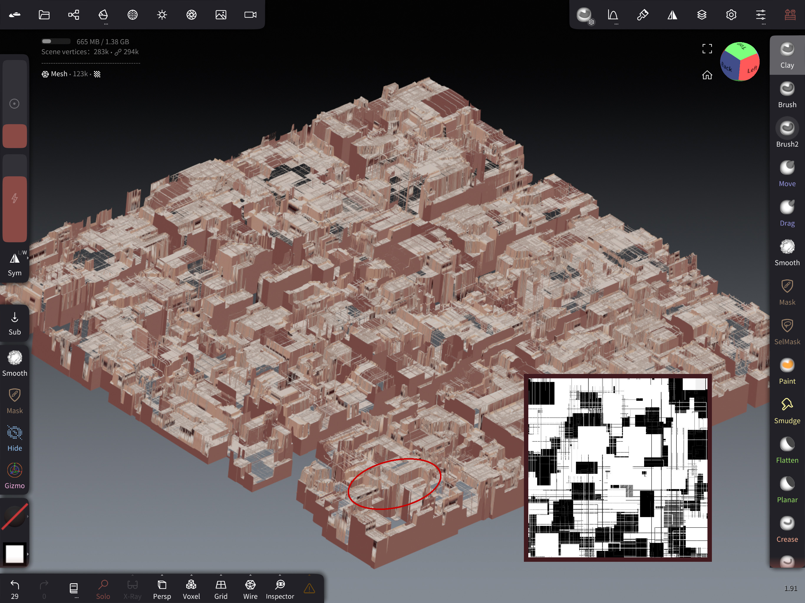

I am also curious, the meshes of the objects are not a big problem with Nomad Sculpt, but I would be interested to know how you do it with the textures.
Nomad Sculpt only has the possibility to bake vertex color on the UVs or to work with reproject.
But I really can’t imagine that you paint the objects hires and then bake them on Lowres, but I could be wrong.
Or do you just throw some City / SciFi texture maps onto the mesh and see what happens?
Or are the objects like the city extracted from the maps?
Where are the textures from and how are they made? And I don’t mean the water textures, but the textures on the spaceships / houses.
Would be nice if you could explain that.
Thank you sir! These are the questions asked in order to make more complex looking shapes and textures. For those buildings I started with a texture I found at some point that would be easy enough to create in any art app. I used the texture as a mask and extracted it using the height map option. (See below)
Then I duplicated this same extraction and rotated it 90 degrees for variation. I then appplied a random opacity map on this mesh to make it feel even more complex. Additionally I created a normal map using a similar texture and layered that onto both of these meshes.
I then scattered a few more buildings. And random structures to add an element of height to the scene.
These images are obviously in matcap view vs pbr for visibility, but I think you get the idea. Most of the color is coming from the lighting in the final render.
Similar principles are being used when it comes to the ships. A little more intentional, but similar layering of details. Hopefully that explains it well :+1:
