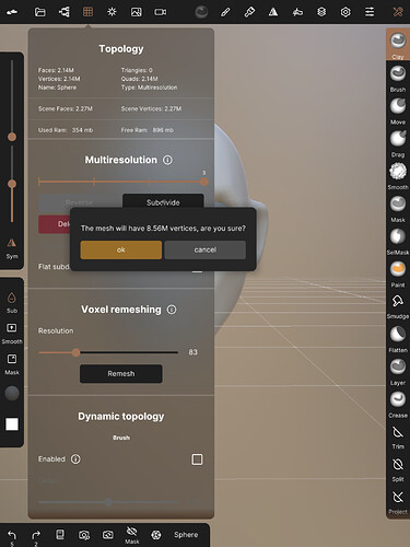

When i try to increase the level of multiresolution of my work the software crash…like every time… I don’t know if it can be fixed ?

When i click « ok » the app just crash every time.
The answer is in the image:
Free Ram: 900 Mb
Used Ram: 354 Mb
A subdivision level multiply by 4 the number of faces and vertices so obviously you don’t have enough memory available.
Something that can help is closing all other apps, but you should probably try to keep a lower polycount.
