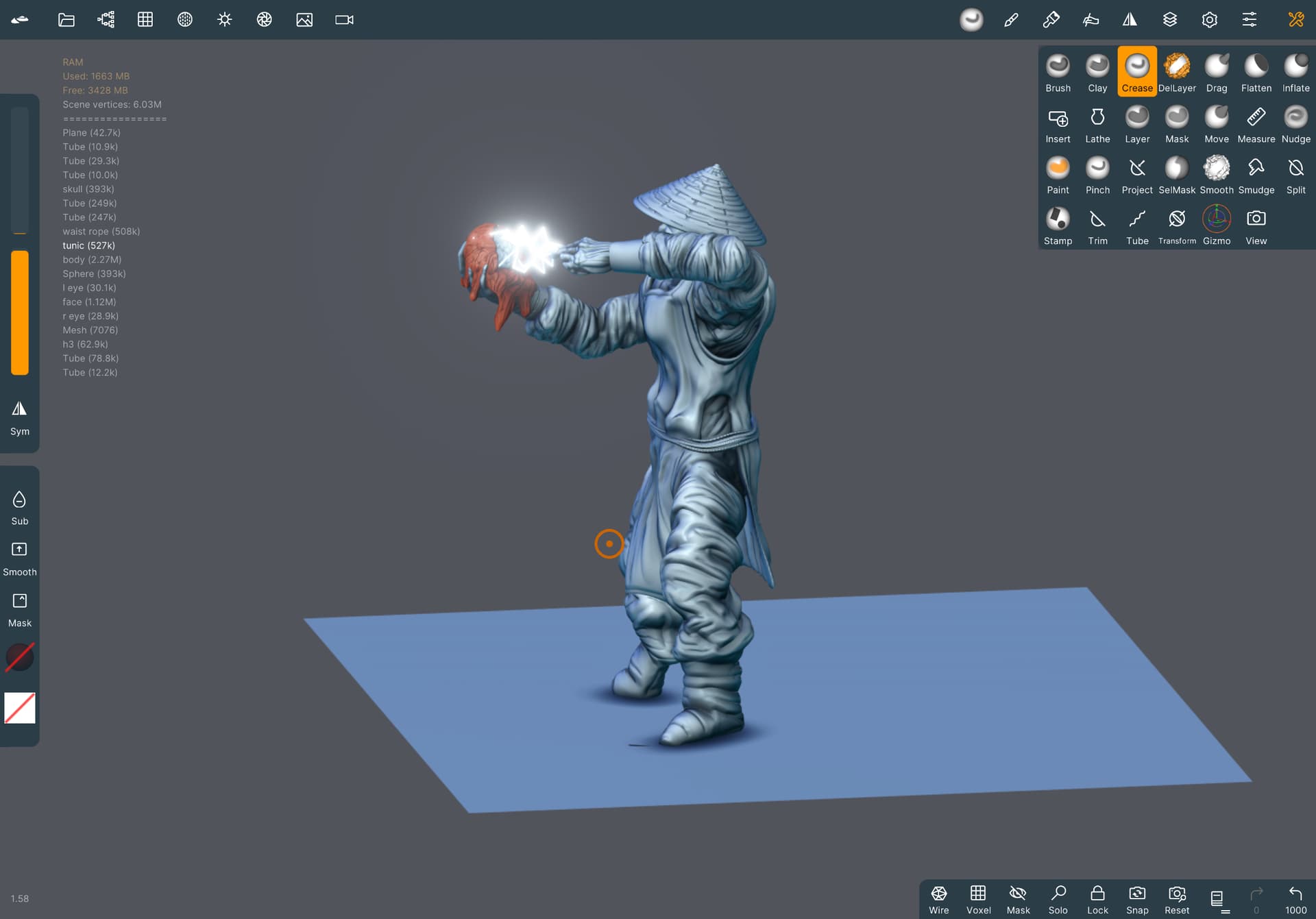

Just to throw in, I find using Nomad works better for me when I think about how classic sculpture is achieved and implement more of those methods digitally. I physically place a plane beneath my characters for a platform to stand on; and they’re modelled pre-positioned first so the feet rest perfectly. Since it’s already pre-positioned, snapping isn’t needed because no adjustments to the posture is needed. I hope this gives some influence and advice towards how you approach your next creative piece in Nomad.

This is example of what I mean in the latest piece I’m working on. Because of no armature, think of the pose you want your sculpt to be in first and design it that way from the ground up, instead of building generic standing figure and attempting to move the limbs after. This is just my own approach to 3d sculpting on Nomad, everyone is different but I find I get better results this way. Tubes are quintessential to my Nomad work, other than the melting face in Raiden’s hand and the Plane beneath his feet, it’s all Tubes. I hope again this provides an avenue for you to explore and inspiration (updated image to show better example from angle).![image|690x481]
@John_Mills Thanks for that terrific reply. What a wonderful sculpt! I wish you success with it.

If the intention is to export the model out for use in software, it requires a different approach to building the model. Mine are for art and potentially 3d printing purposes. I’d honestly make quite a simplistic figure in a T-pose, basic mesh, low poly, spaghetti limbs for ease of animation and exploration, then export him out for all the heavy lifting in the planned software you intend to finish him off in. For that, you won’t need much Nomad use at all.
But also, the reason for my choice for that will also be down to the technical restrictions from my Mac and my lack of personal interest in exploring animation. For someone who’s already seasoned in it - like yourself - your approach may well be different and you may want to build something more complex. This is just my input. Good luck.
