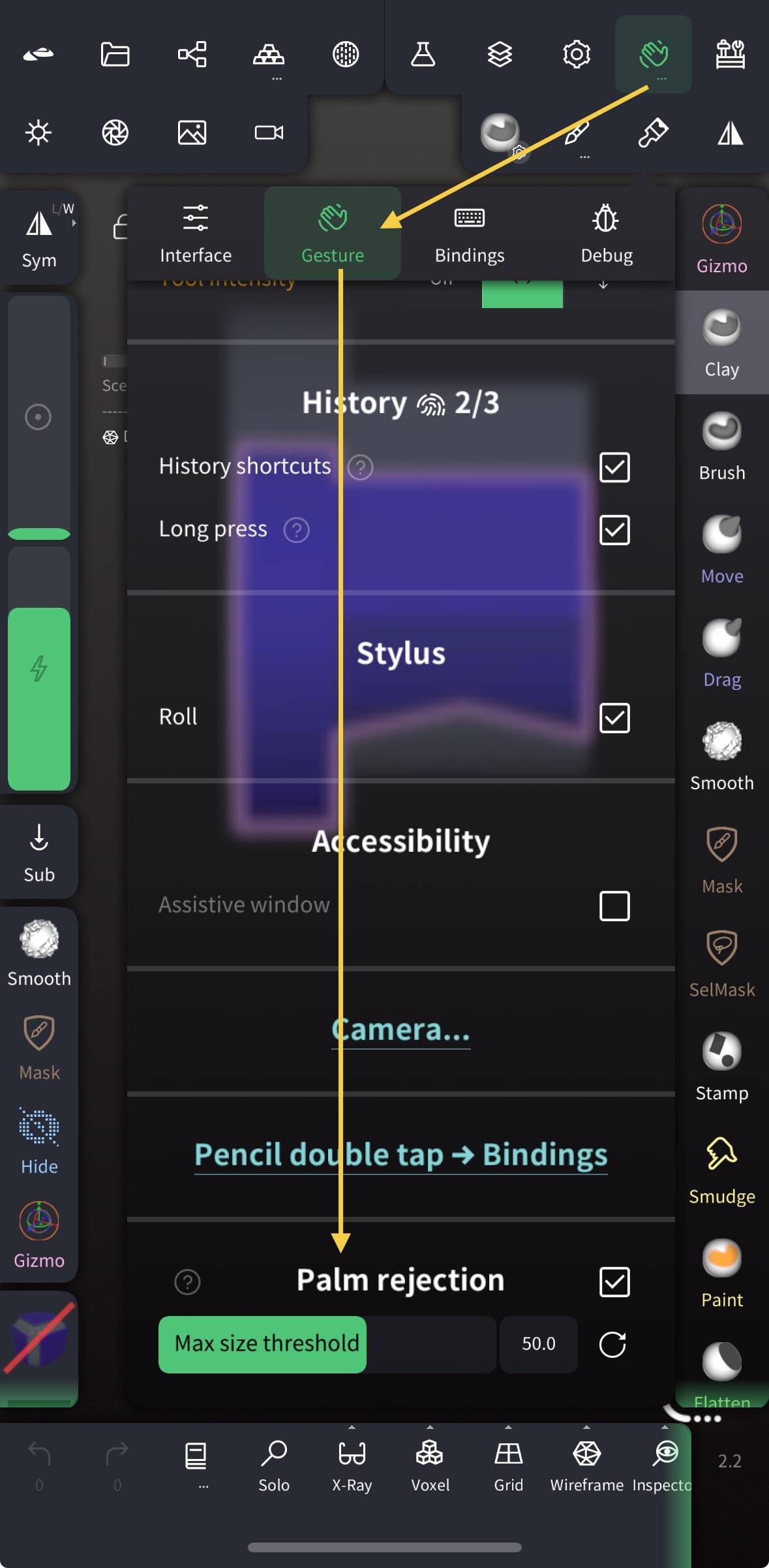

Maybe check your Palm Rejection setting? Disable / Enable it and change its size?
It sounds like it’s turning 2-finger interactions into a 1-finger interaction. I’ve noticed the Palm Rejection can sometimes alter interactions in this way.
Other than that, try spreading your fingers more?
Aha! Yeah that’s done the trick. Thanks :folded_hands:
