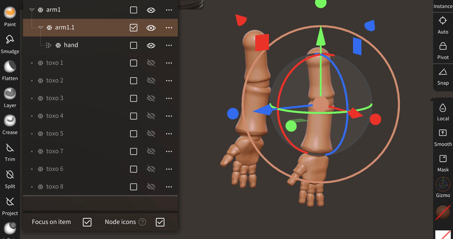

I’m probably forgetting something but I can’t move the meshes grouped.
I have them grouped as you can see, but when you select one and move it, it moves independently of the others parts. I have tried the web version and it works.
Must do something special? ![]()
Gizmo settings → auto or group
If on auto make sure symmetry is off and your mesh has no masking.

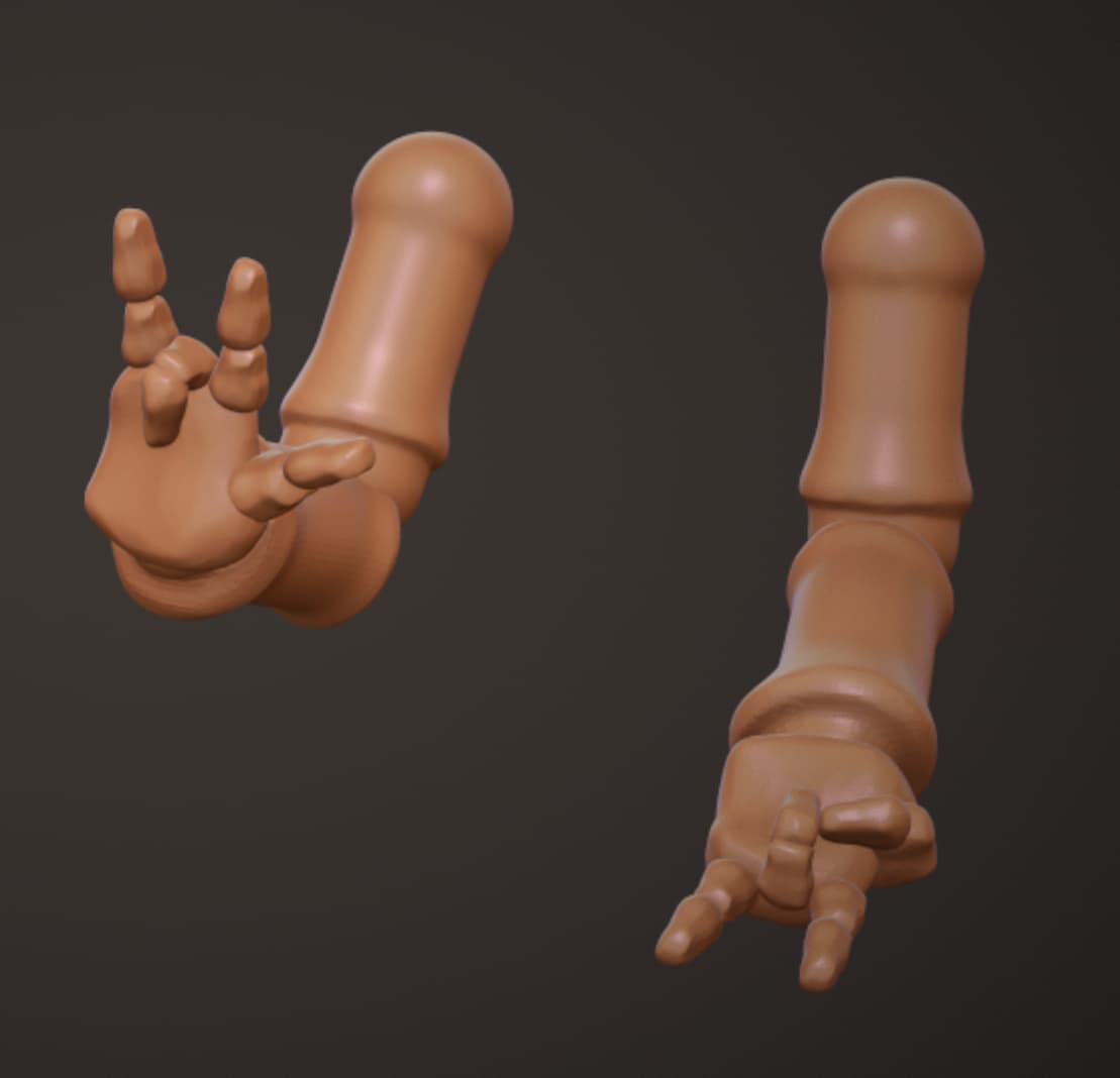

Thanks @stephomi , works perfectly, but now both arms move identical, I mean that moving on red plane works but on green or blue planes don’t, so was created mirroring the part. If I separate them I lost the groups, right? Or I’m doing something wrong? ![]()
and symmetry is off for each part.
