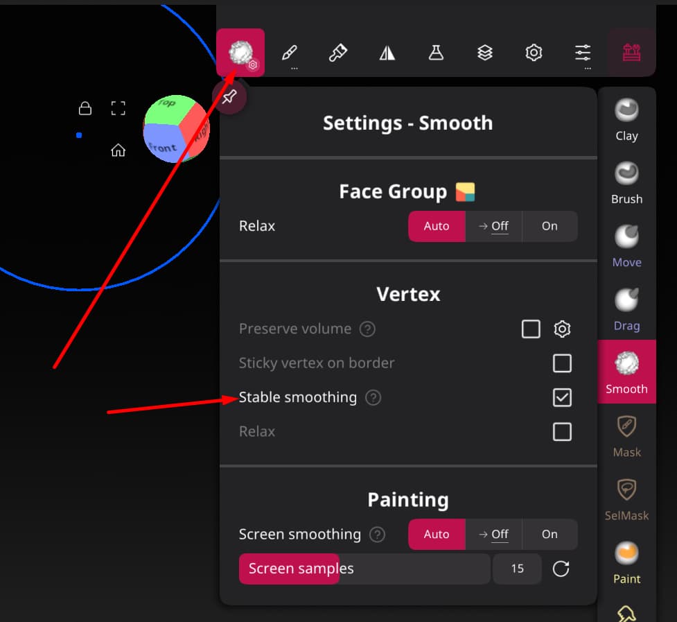

Hi there. I use this type of smooth heavily in my workflow on zbrush and I’m looking into switching over to Nomad on PC.
if it’s not exposed int he UI how do I use it?
Yeah I’d love a similar feeling one as well, I also use it a lot and helps with removing bumps and lumps on remeshed or voxelized meshes by reducing the pinching effect.
@DootSnoot, you can find what @stephomi mentioned right here I believe! You just need to have smooth tool enabled. I don’t think it can replace the Smooth Alt for me, but it might have other uses I have yet to find.
Stable smoothing is only for varying density, honestly it’s almost never useful.
The zbrush alt thing is actually “preserve volume” in your screeenshot.
Ahh my mistake!
I used it before thinking it was the same, but I didn’t get great results. Using it now while I keep voxel remeshing and cleaning up the mesh it works better…
I will keep tinkering, thanks!
