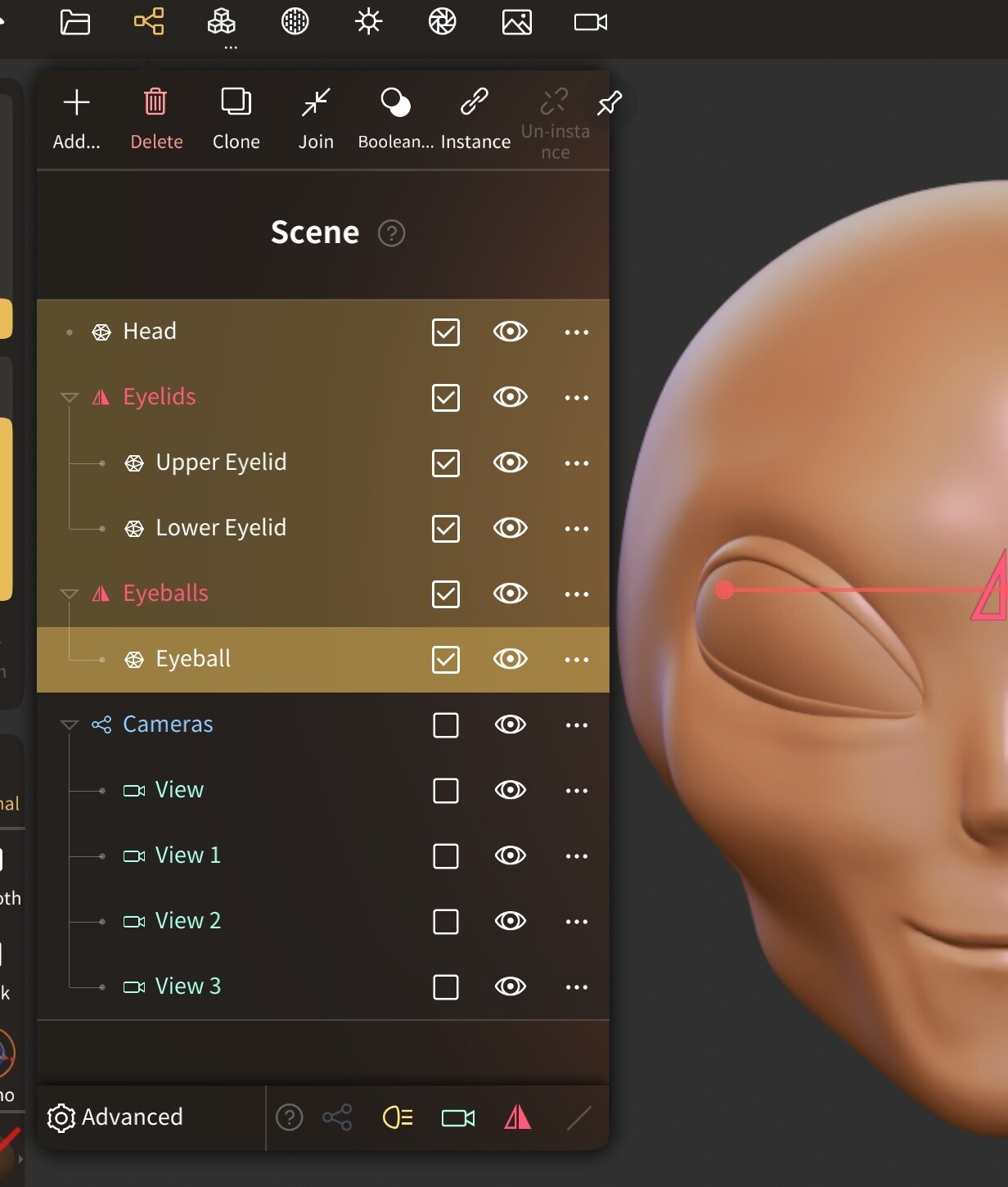

Hello. I need to use the move transform brush tool to transform 4 objects at the same time.
The side of a face were the eye ball, and the upper and lower eye lids come together. I need to change the shape of that area and it will afect the 4 objects.

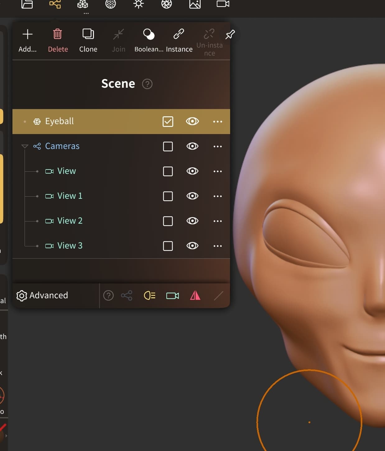

I tried by selecting them all in the objects menu but when trying to use the tool it just unselect them all expet one so only one can be transformed. Then I tried by joining them with the hope to be able to transform them all and the un-join them but again it only transform one object. At this point is to early to merge them all together.
Is there a way to perform this action?
Trying to find solutions on how to do it I only found people trying to do the same with out succes like in this old thread where in one question somebody was asking the same. But I decided to open a new one with a more acurate title because is not about moving is about transforming with a tool like the moving brush. There are other threads but no answer on how to do it Moving multiple objects together - #2 by stephomi
When you joined the objects, have you changed the tool settings ? The connected topology setting ? If the setting is wrong only one object of the joined mesh moves…

Sadly I have it like you have it in your screenshot, but in only moves one object.
You cannot sculpt multiple objects simultaneously, you can only move them with the “Gizmo” or “Transform” tool.
There is a special case when some of the objects has masking on it, in that case it’s considered sculpting but it only works with the Gizmo/Transform tool. That’s the only exception so far.
After joining them, make sure to unselect “connected topology” for the Move brush.
You guys are awesome :ok_hand: :heart_eyes:
So connected topology needed to be unselected.
Now it works like a charm.
