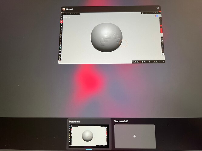

I have a few problems with Nomad PC. I’m currently using version 2.3.28 on a display tablet (Huion Kamvas 19 Pro). The three-finger swipe gesture (up and down) used to change the brush size doesn’t work most of the time. If I make Nomad full screen, it doesn’t work at all. Usually, Windows’ multi-window system gets triggered instead.

I’d like to show it with a video, but it’s not allowed due to the file size limit. The undo function doesn’t work at all when the pen is close to the screen. When I lift the pen, it doesn’t activate immediately either. The redo function doesn’t work at all. And sometimes it does undo.
The brush resize gesture almost never works. Whenever I try to use the three-finger swipe gesture (left-right or up-down), it either triggers the Windows window switcher or nothing happens.

Did you disable the windows 3 fingers settings (windows settings)?
An app cannot disable these so you need to do it yourself. It won’t solve the bug with pencil hovering though, I’ll look into it.
Yes, it fixed the issue when I turned off those settings, but there was no change when using the pen. Thanks.
