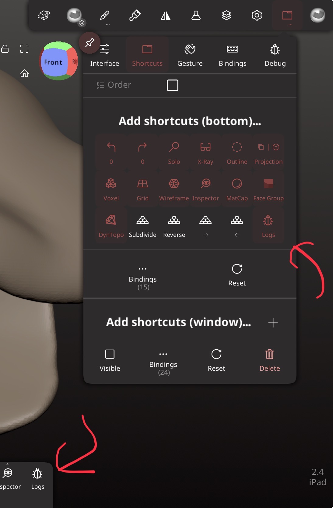

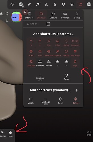

  • do you use the pencil with hover?
  • when it freezes do you still see the cursor moving (the orange/red one)?
There are some app logs (I doubt they will be useful for freezes though).
