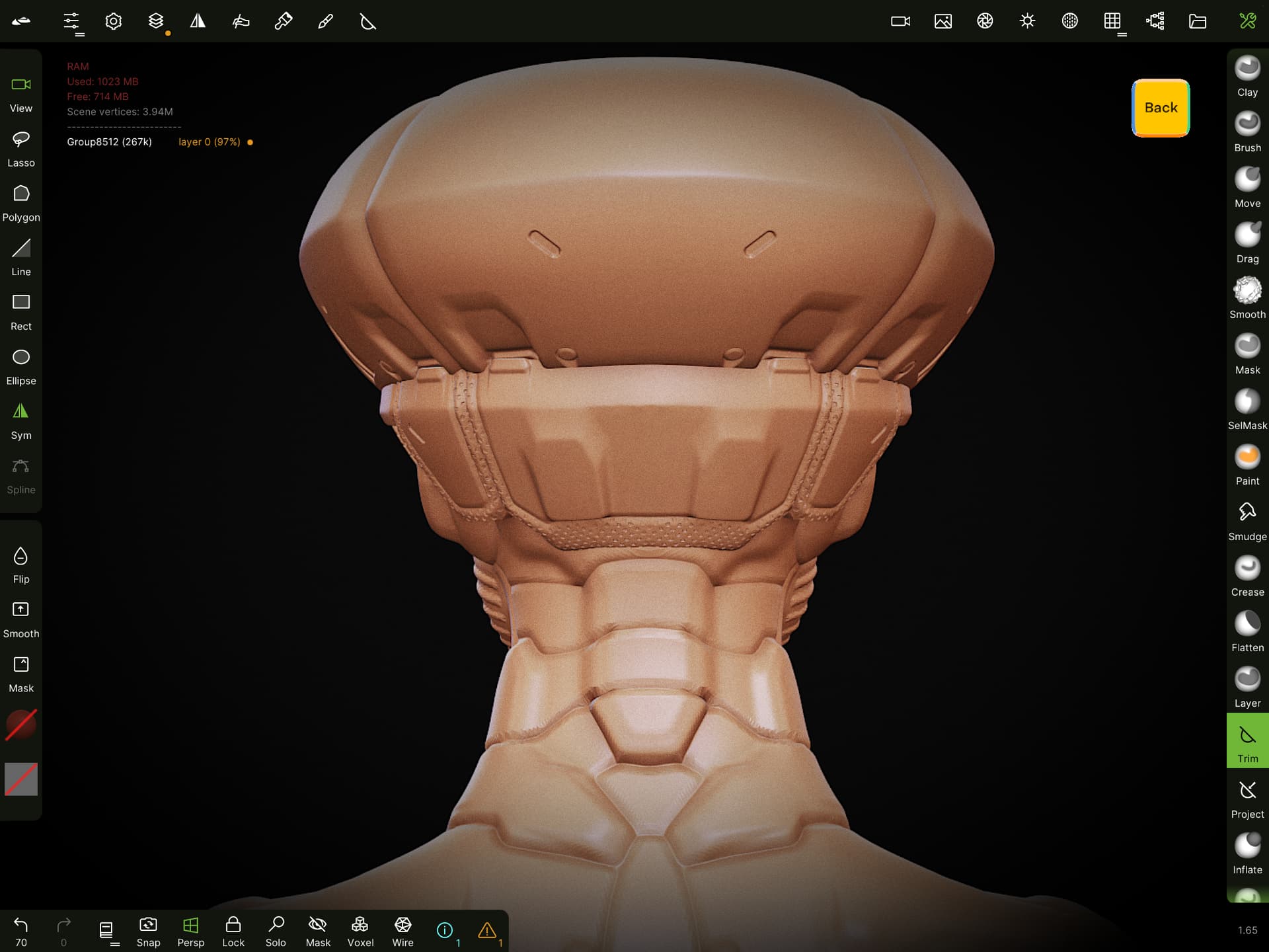

I Make a base head to future helmets test.
I´m so happy with this program, its amazing. Only some problems with my iPad (No Pro). I think I touched polygons limit…
This is my first “Spider Vision” helmet (WIP) based on my color concept.

Btw, for helmets tests, you maybe want to check the decimate function for you head? It works very well and can save quite some polys.
This head with helmet had decimation. You right, Nomad work decimation right!!

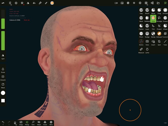

Maked some test extras
Unlit color paint
This is great! Which iPad are you on and what is the poly limit? Mine is around 6 mill.
7th generation 10,2""
Me too, around 6M
