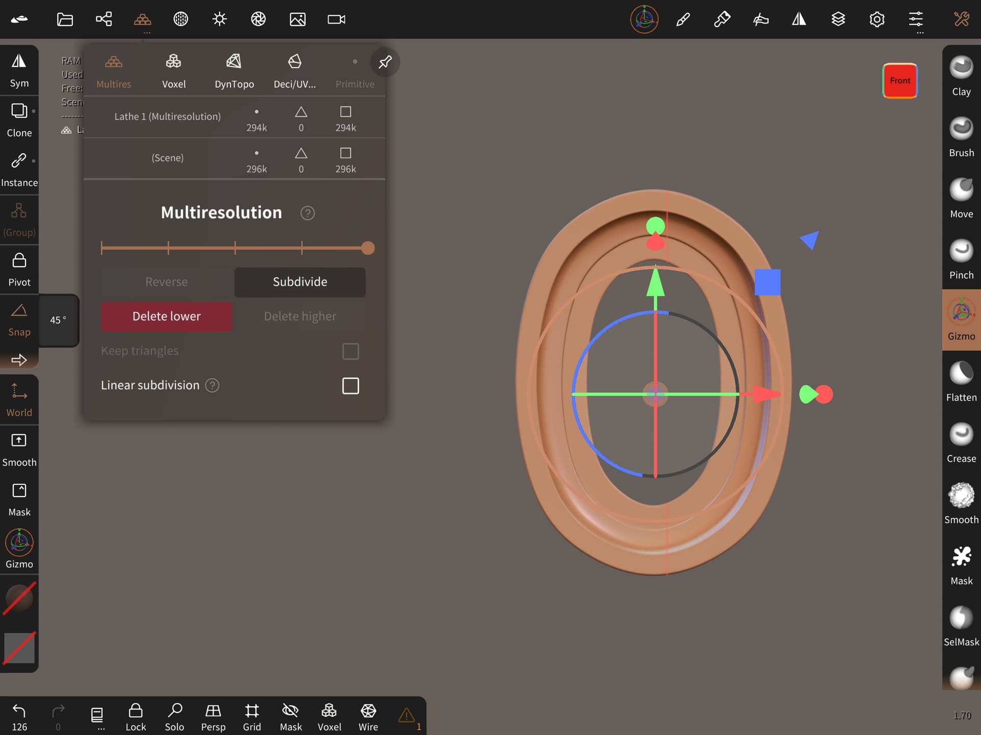

I’ve been working a lot on hard surface sculpting techniques recently, and hope to post a lot more sculpts soon. Here is a simple but effective molding profile turned into a picture frame. I’m working on a technique to extrude profiles along any shaped curve and will post the results soon, but this is a good first step.

Yep, you’ve pretty much got it: almost the same technique as with angled object. As you know, we can’t do true “extrusions” in Nomad, but the technique I’ve worked out is fairly quick anyway.
Create profile with lathe tool. We’ll be using subdivision later, so make sure there are at least 2 sharp control points wherever you want sharp edges on the profile (this creates edge loops in the standard box modelling sense).
Set lathe geometry so that there aren’t too many divisions of the circle - the will depend what shape you ultimately want to achieve
Validate
Use mask select to select individual profile “edge loops”. Use gizmo to rotate and move them into position manually. For a shape like the oval, you won’t need many.
Once you’ve manually “roughed in” the shape, use subdivision, to round out the shape.
The sharp edge loops on the profile will make it hold it’s shape, but the overall contour will become rounded; basically like using a subdivision surface modifier in blender.
The first time I did it it took a while, but the example in this post was 5mins max.
