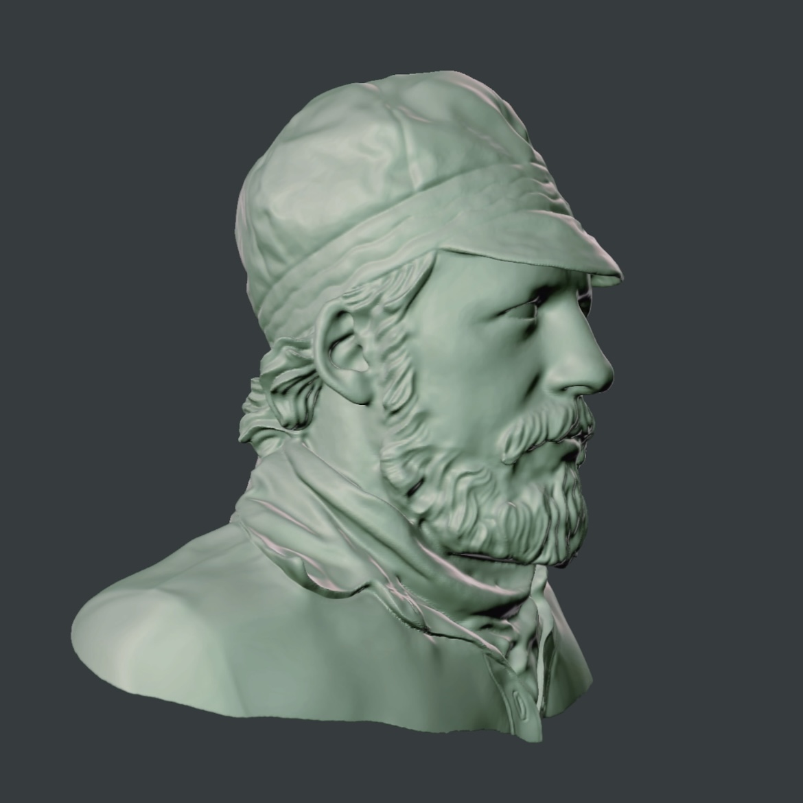

I used ScandyPro to scan a coworker with my iPhone and then put it into nomad and tuned it up a lot then printed it.

I tried doing a scan once and since I don’t know how to use nomad yet I couldn’t figure out to erase all the little artifacts that are out in space away from the model. Any tips on deleting those?
In ScandyPro app after you scan you can utilize an auto cleanup feature that will get rid of most if not all of those. Once it’s in nomad you can just use your trim tool and proper view points to delete them out. I’ve found that artifacts close to the surface can be smoothed away. I like to turn on dynamic topology to smooth out any stray artifacts along with unwanted holes.
Thanks. I found that using the trim tool sometimes would go crazy and morph my scan into an abstract redesign. That might be why you said using the proper view points. I’ll keep working at it. Thanks for the tips.
@RiserStrike One option would be to hit the Scene tab, select the object, hit Separate just below, and delete all of the offending objects. Bit of a long way around, but still effective.
The way to do this with the trim tool is to turn off hole filling - it makes abstract art because with hole filling on, it’s trying to fix non-manifold “open” meshes. With hole filling off you simply get the messy mesh removed from the model :+1:t2:
