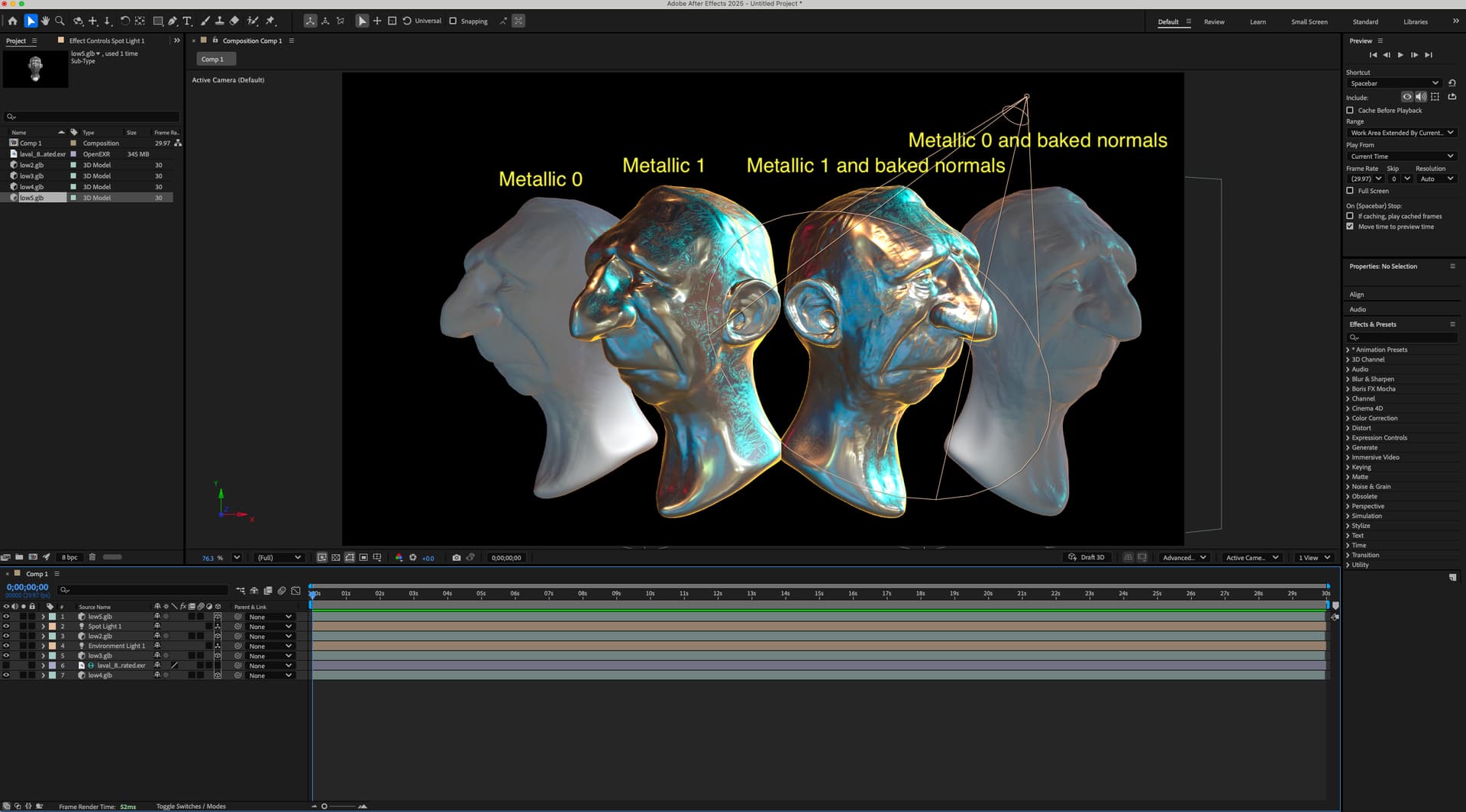

Just had a go, try using GLB instead of OBJ, and ensure normals are enabled in the export options:
You can choose to bake normals and colour and whatnot, but thats the main issue here.
Here’s a test with various paint options. Remember to add an environment light with a nice HDR, if you don’t the metallic surfaces won’t look very good.
