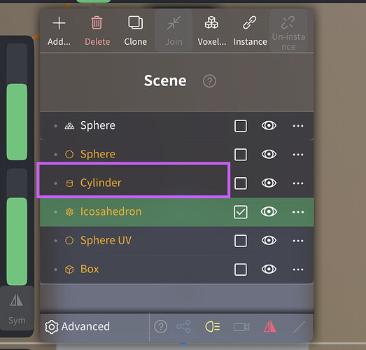

Tap and hold on an object in the object list within the area outlined:
it doesn’t work, it just drags the list
Make sure to long press while standing still.
Thanks, that actually works! I tried everything except that… it is hard to be exatly still with the pen maybe that’s why I never found how to do it
